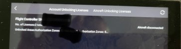

Do you have a clue why it says aircraft disconnected
