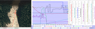

Now when you've made your Google Drive public I could have a look at the mobile device .DAT log you had there ...
It doesn't show any other reason for the lost view in your screen device than what the message said ... "RC not connected to the MOBILE"
You were commanding left roll with a slight input of yaw at roughly 11m above the HP when the log stopped. No abrupt movements was seen in either roll, pitch or yaw before the end. The satellite count & navhealth was sufficient for a stable flight, but was dropping just in the end. Surprisingly you had the failsafe setting at Hover instead of RTH ... doesn't seem to be the right place for that?
You had 86% battery when the log ended & by interpolating out from the earlier consumption the AC drained 1% each 15,7sec ... meaning that the power would have lasted approx 19,8min. before reaching low battery auto land at 10%. But well before that the AC would have low battery RTH ...
So either it's a mystery that the AC didn't low battery Returned To Home ... perhaps the height was set to low (don't have that info in the DAT) & crashed into something on the way back ... or you didn't wait long enough before giving up the hope ... & it actually returned & are waiting on the spot now ... or you continued to command the AC with that roll a bit after the live view disappeared & hit those trees nearby behind the AC ..?
You most likely had RC connection to the AC all the time ... if you only had pushed the RTH it most probably had done exactly that ...
(Click on the chart to make it larger)
