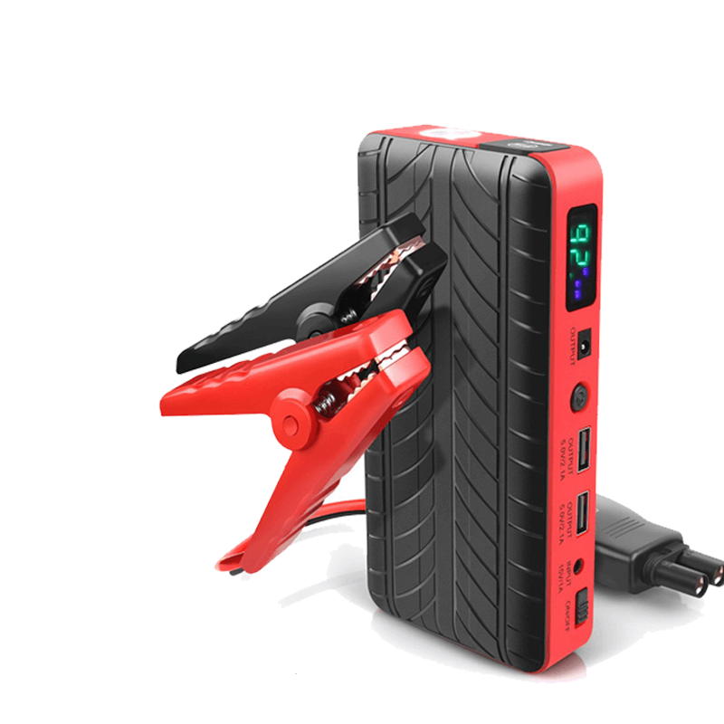

What about getting a power pack? Something like this that you could take with you. At least you would get a few charges in. Not recommending this one, just using it as an example.
With a cable cigarette light plug like this ?
Would work IF the voltage for a particular charger is around 12v - 12.5v . . . not the M1P, MP2 for sure, without a step converter.
(Not sure what voltage the OPs MA2 charger requires.)
