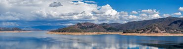

The 70mm especially has been an absolute champion for stitching😀. The stitched panos can be printed large and look stunning exhibiting incredible detail. Even a pro landscape photographers shooting with MF cameras and not familiar with current drone technology are amazed and can't believe that this is possible to achieve with a tiny flying machine😀. Something like this simple 3 shot stitch can be printed 40" wide without any problem
