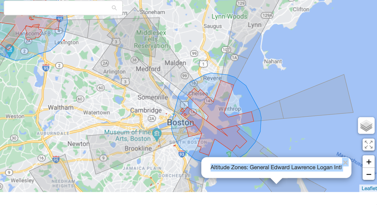

It used to be red restricted area could not be self-unlocked. But the blue and grey areas, you could get instant unlock.
NOW DJI is calling the grey areas "Altitude Zones" and you have to custom unlock them?!
What a laborious and time consuming pain in the rear.
I really might get an Autel because of this.
I unlock these zones (after getting LAANC) dozens of times a week.
Having to screenshot the approval, fill out a form, submit on DJI and wait for approval is so freaking frustrating.
I have two approvals going on an hour now. That used to take me 30 seconds.
I am beyond frustrated.
You can fly under those grey Altitude Zones extending in fan-shapes off the ends of runways as long as you don't exceed the altitude restriction. The first one, nearest the end of the runway, is usually something like 60m (~200ft), and the further one out is 150m (~500ft).
A custom unlock is only required if you have a valid need to fly into those zones.
If you are flying below that height in those areas, you might get a warning message telling you that the Altitude Zone is there. If you try to ascend up into that Geo zone, or are already flying higher than that and try to enter into the zone from either side, then the DJI Geo fence will stop your drone at the boundary of the Altitude Zone.
Just like any other DJI Geo zone, you always need to be aware of where those are located and how they function. If you happen to lose control signal and your automatic RTH tries to climb up into, or return through, such a Geo Zone, the drone will be blocked at the edge of the Geo Zone until low battery forces it to land. It might never come home. So always check your RTH settings and path, so the drone doesn't cross any Geo Zone that might block its return.
