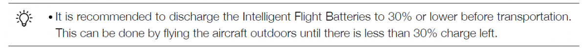

Thought I read somewhere it is advised to discharge the batteries to 30% when transporting. Assume this means for long distance or flight.
Going on vacation and it'll be a 12 hour drive, going to discharge the batteries but do you all think it is really necessary traveling by vehicle?

Edited my first post to reflect the correct information per the manual, it's actually 30% and not 50%, but does not specify what is meant by transporting.
Assume traveling by vehicle wouldn't be any different that heading out to a location to fly. If I was going through the mountains where there's a significant change in air pressure then perhaps I'd be more concerned.
Link where I read 50% for transit: Battery Care is More Important than You Think - DJI Guides

The batteries will automatically go into discharge to a storage level after 9 days, a recent change to the Air2S (I think it used to be 4 days), so if going by plane, etc maybe take/pack them after they reach that point so they are already in that storage state?
Although the info you posted regarding 50% for transit is a good idea it is outdated now with the Smart Batteries.

I think the 30% rule is for commercial transport carriers like FedEx, UPS, United Air, etc., and not for personal conveyance. Before you or the manufacturer ships the battery it much be discharged to 30% or less.
