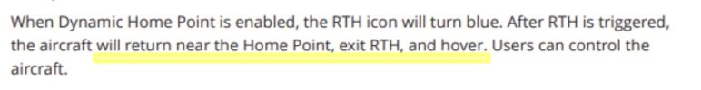

I'm curious because I'm trying to understand how the drones sets the altitude to hover when it reaches the home point. When I tried DHP runs on the Mavic 4 Pro, it seemed to be related to the RTH altitude I set.
It's stored in the settings on the controller.
I performed some tests to determine the height at which the drone stops when doing a RTH with Dynamic Home Point active.
I set the Auto RTH Altitude to 30 m (~100 ft) for all test cases. I started the RTH with the aircraft at 40 m (~130 ft); 30 m (~100 ft) and 20 m (~66 ft) altitude and about 120 m (~400 ft) from the location of the Dynamic Home Point, in each of Optimal and Preset Advanced RTH modes (so six test cases in all).
In all test cases, bar one, the drone stopped and hovered at 30 m (the preset Auto RTH Height) above the location of the Dynamic Home Point, and landed within 0.5 m (~1.5 feet) of the controller location when I dropped it straight down.
Environment was a level, open area. GPS HDOP at the time was 3.8 (which implies good accuracy for GPS location).
In the other test case, the drone stopped at 26 m (~86 ft) above the location of the Dynamic Home Point. In this case, the RTH was initiated at 20 m (~66 ft) altitude (i.e. below the Auto RTH Altitude I had set) with Optimal RTH mode.
I think this is consistent with your impression that the Mavic 4 Pro's hover altitude is related the the RTH altitude set.
I agree. I'm still wondering if the DHP hover altitude is increased when there are nearby obstacles. I've not done any tests to sort that out, since I don't have any immediate need to use the DHP feature.
