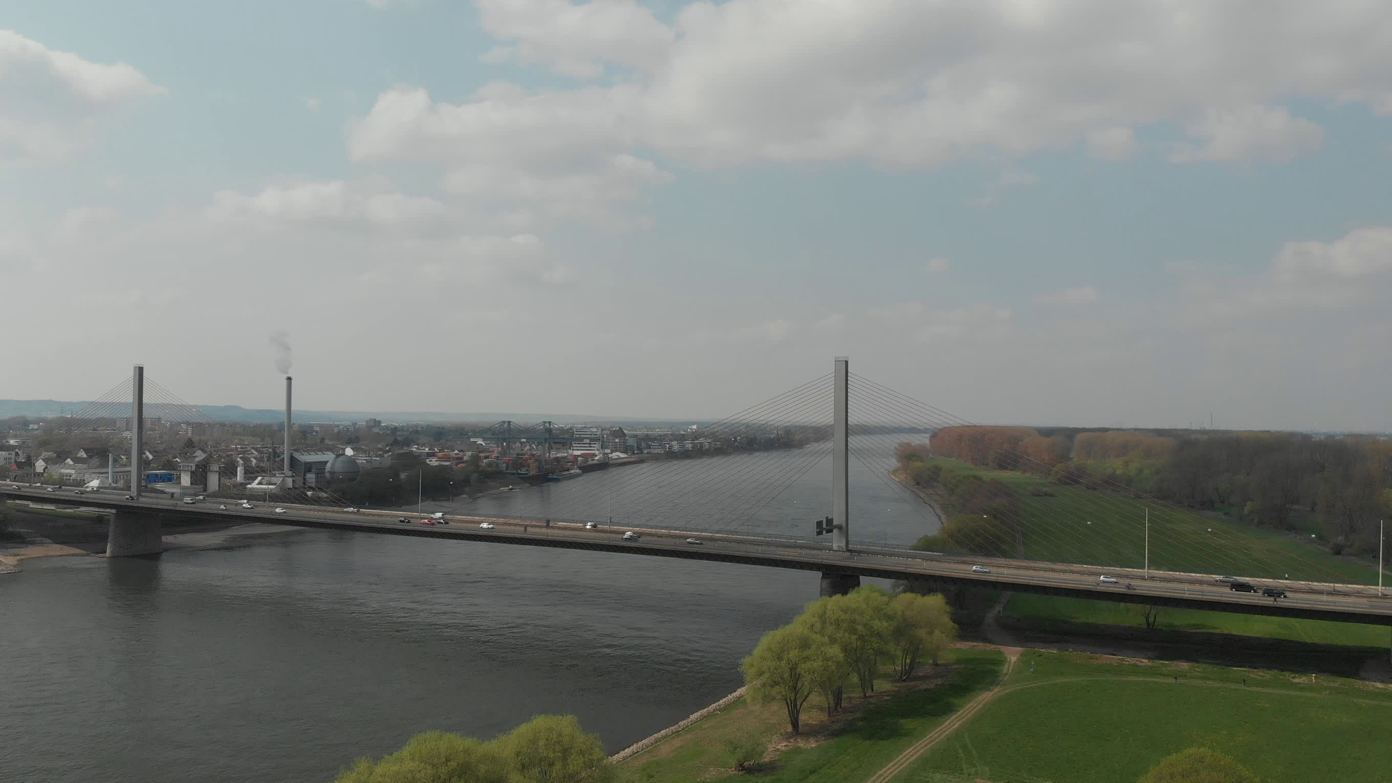

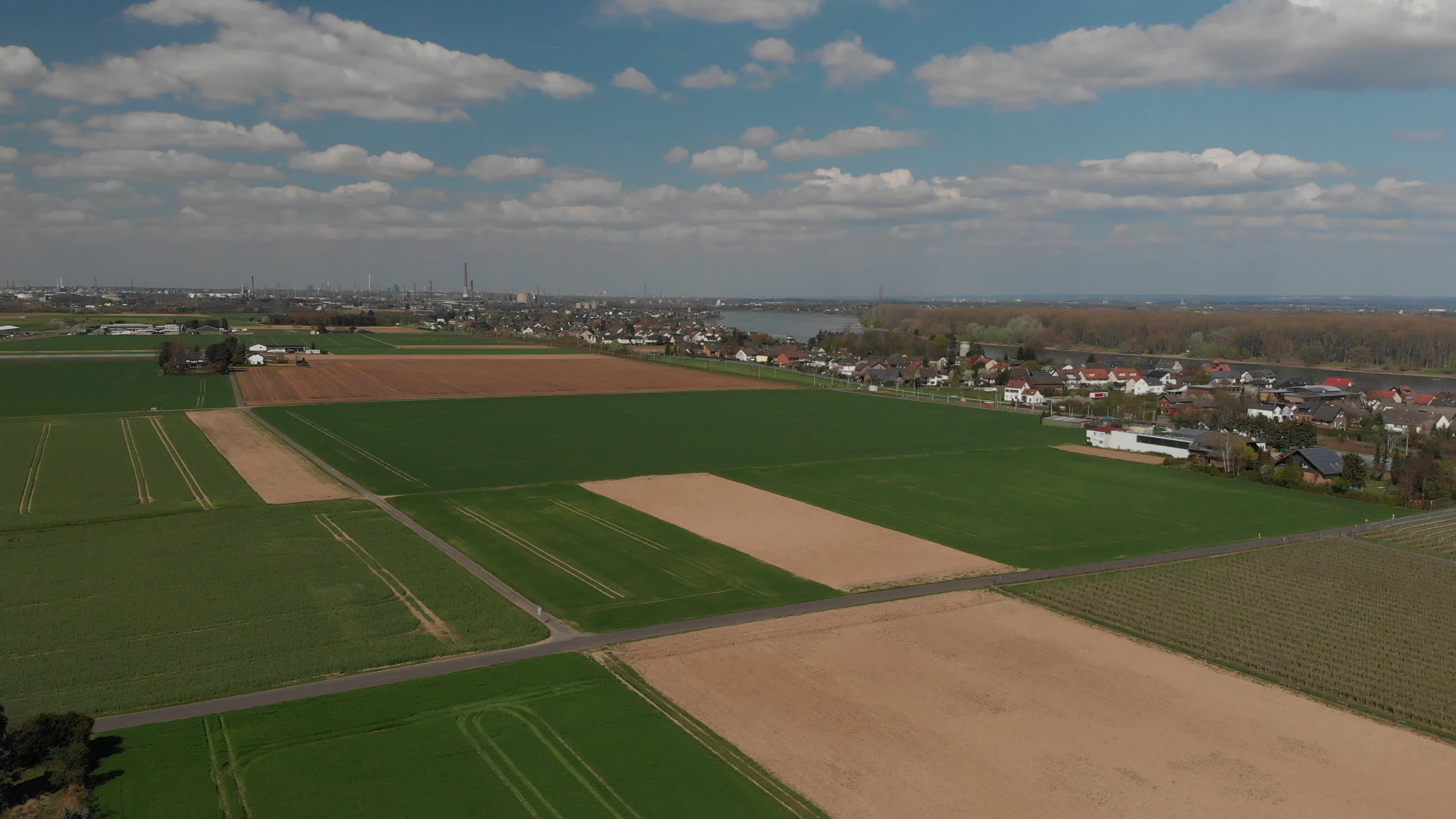

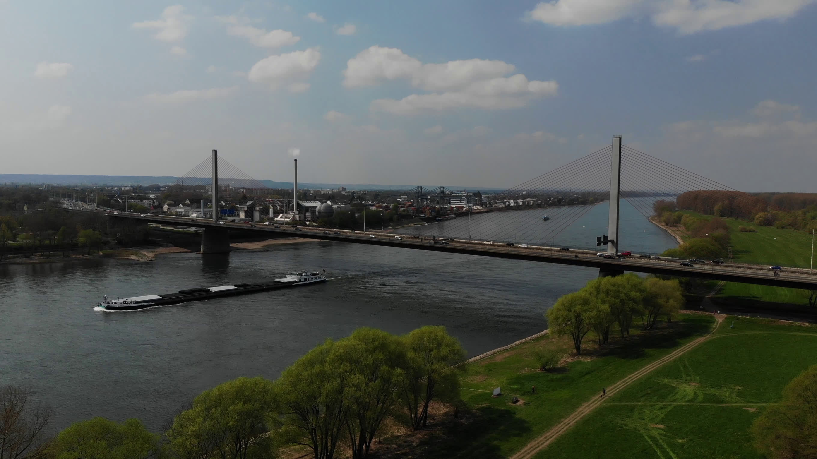

So, I took the Air for a spin today and decided to give the CPL filter a last chance to prove itself. It was a bright day, full sun, no clouds in the sky and 1pm in the afternoon. I was flying around a small lake surrounded by farms. Filmed with the CPL filter on first and then a plain ND32 filter. And the CPL filter has won me over again; the contrast, and the colours are just gorgeous! See sample screen grabs below. And the ND32 proved to be to dark even for such a bright day.
Edit: first three are with the ND32, last three with the CPL filter on
