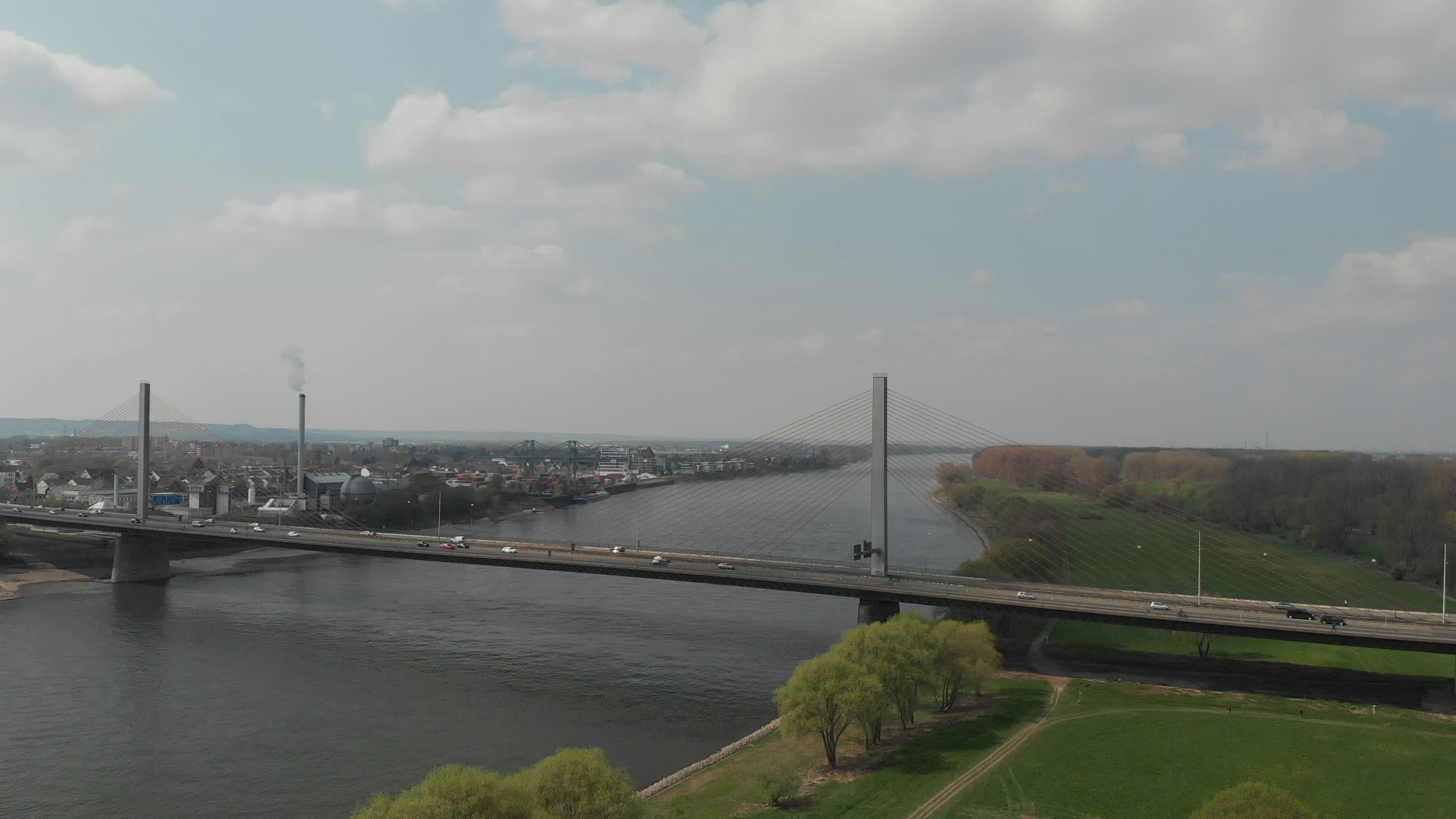

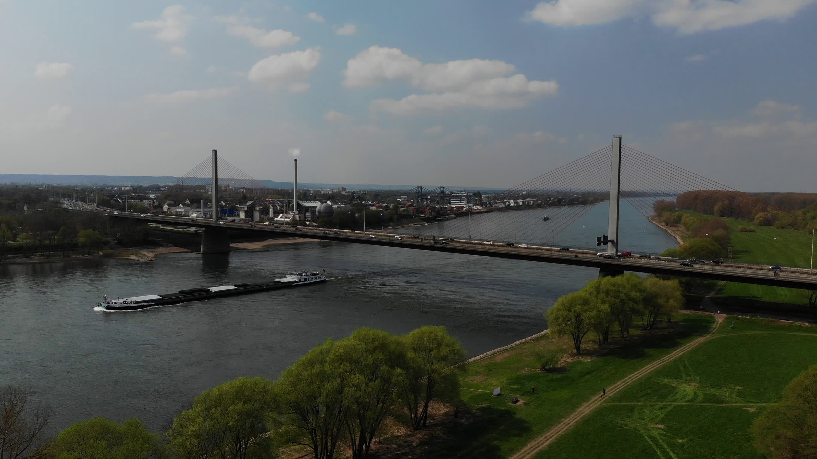

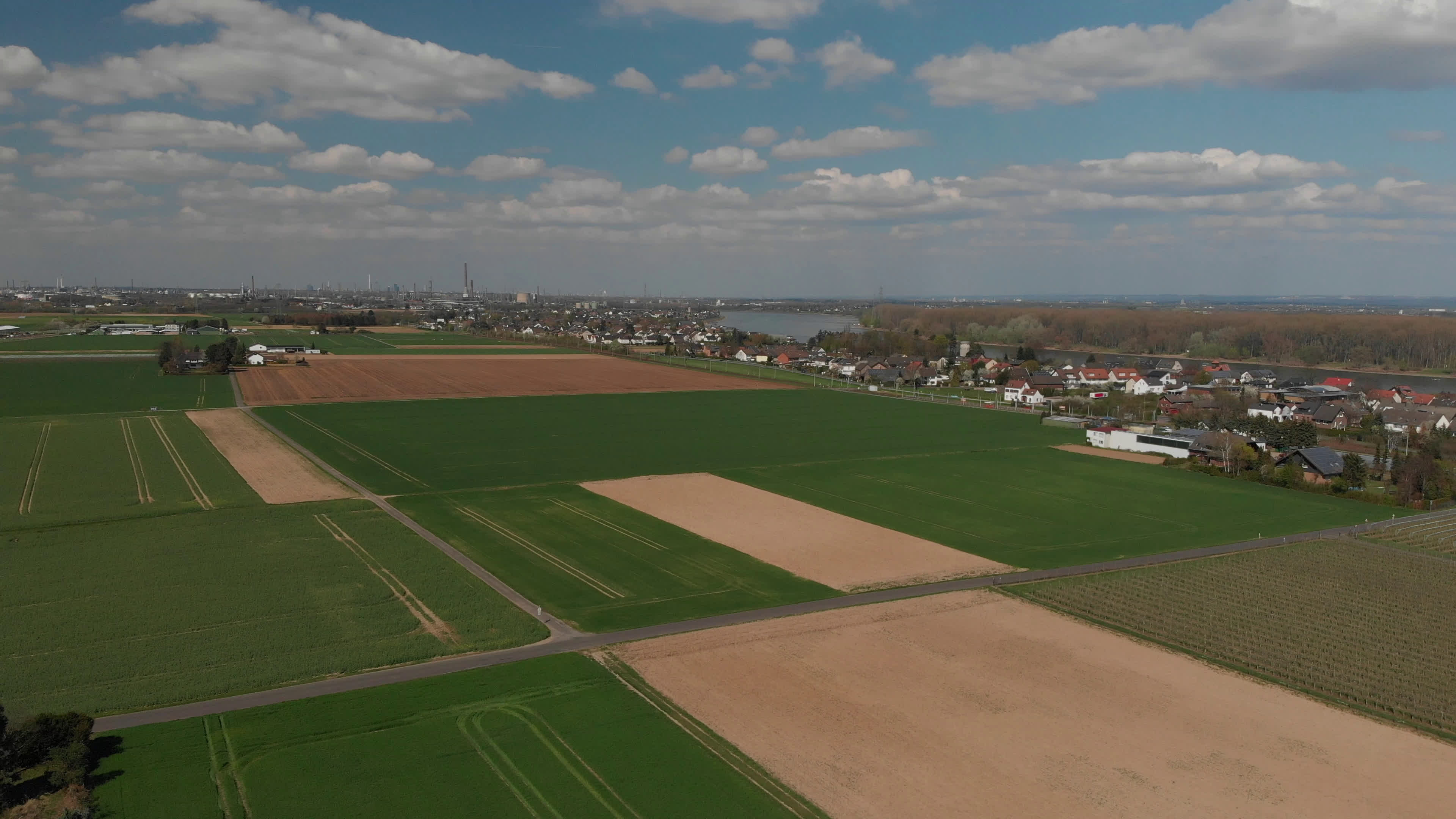

I just can't seem to be able to get a consistent performance from my cpl filter; when you get the angle right - it is awesome, the colors are much more vibrant (especially on the sky and vegetation) and there is a nice contrast to the footage that is hard to get otherwise. But when you don't get it, the footage is just awful! I give you exhibits A, B, and C! First one was nice, second was ok, third is just horrible. Also, this histogram stuff is hard - how does one get it bunch up in the center? I leave my ISO at 100 and try to fiddle with the shutter speed but that doesn't seem to work much.

So, I took the Air for a spin today and decided to give the CPL filter a last chance to prove itself. It was a bright day, full sun, no clouds in the sky and 1pm in the afternoon. I was flying around a small lake surrounded by farms. Filmed with the CPL filter on first and then a plain ND32 filter. And the CPL filter has won me over again; the contrast, and the colours are just gorgeous! See sample screen grabs below. And the ND32 proved to be to dark even for such a bright day.
Edit: first three are with the ND32, last three with the CPL filter on
