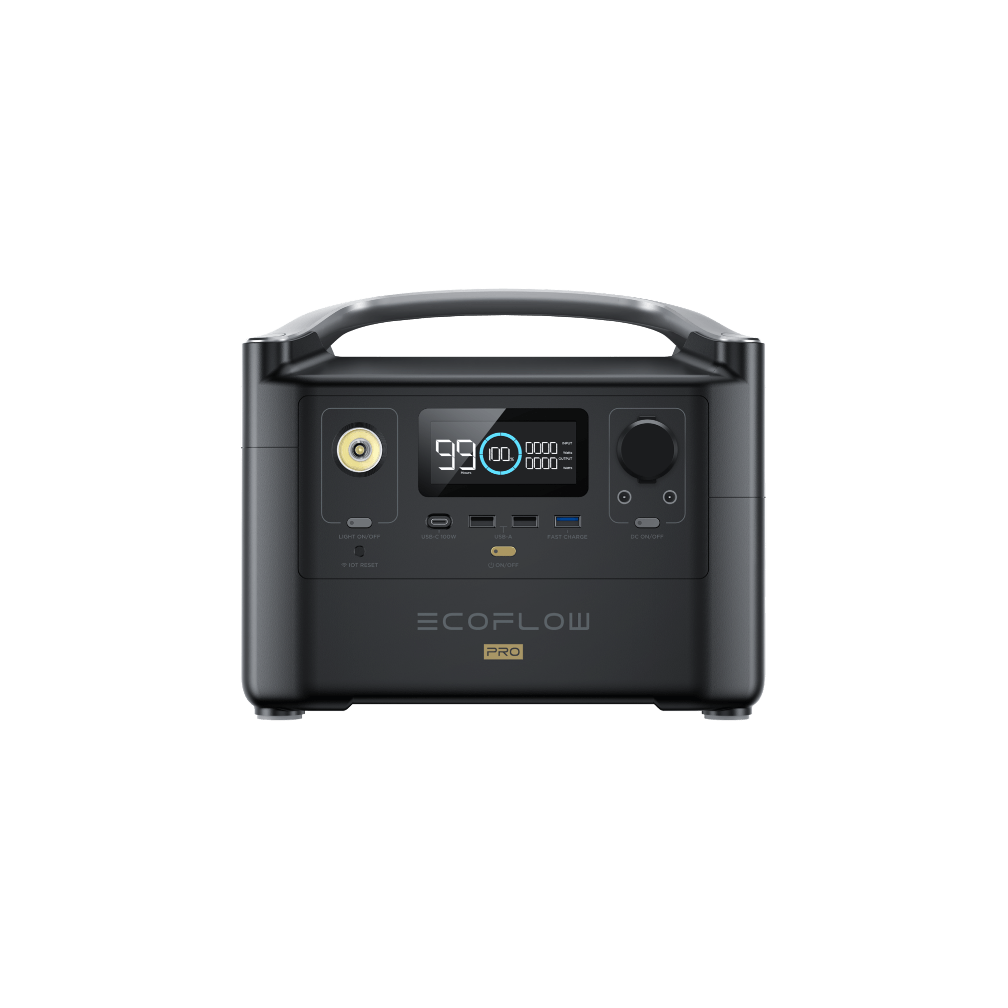

Power banks are use more as a small charging unit with are small and very portable , where as a power station is not something you can carry in a jacket pocket or backpack. Just check Power Station at Amazon and you will see what I'm referring to.
That has a much larger storage capacity and can easily charge multiple drones batteries many time. Some start over $150 and can go up to over $1000 depending on how big and how much power you need.
A small cheap $50 power bank may not charge large drone batteries as well and can basically charge a cell phone about 3 or 4 times. But not designed for large loads.
Something like this would be good. I'm not specifically recommending that one, there are many you can look at, but that one one of the first ones that came up in the search that isn't too expensive and would be sufficient capacity to last you all day.
It has a decent capacity and you can even use solar panel if you need more power and want to charge it.
A small cheap $50 power bank will not charge large drone batteries and can basically charge a cell phone about 3 or 4 times. But not designed for large loads.

Yes, the Power Station is good when traveling by auto. But, to carry around, you want the largest Power Bank you you can get.
