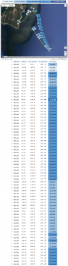

1 word………. Headwind.
This is only a calculation of course, but here's the wind speed according to Airdata:
Reactions: RodPad and Meta4
