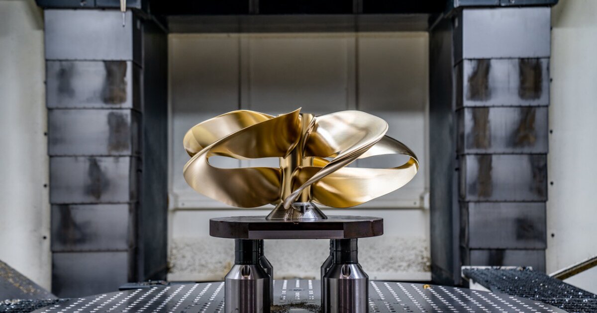

The Toroidal prop trade off efficiency for a quieter operation... but the keyword here is "should be" quieter, most of the drone toroidal props aren't, instead adding more blades to a conventional design usually win in that regard. Then the biggest downside with Toroidal props... the efficiency. Most examples I've seen means a 75% shorter flight time & that with a much reduced stability.
So no... in total Toroidal props on a drone isn't a success so far.
Reactions: GFields
The articles that have been around lately claim higher efficiency in addition to reduced noise.
The team analyzed these weird-looking toroidal props to see whether there would be a thrust efficiency penalty. Apparently not: the team's best-performing B160 design was not only quieter at a given thrust level than the best standard propeller they tested, it also produced more thrust at a given power level
Yep ... but not much have yet shown up, most are terrible efficiency wise.
They now pop up on my YouTube recommended too.
😄 That's how YT's algorithm works... the more you look at a subject, the more of the same they feed you.
Reactions: MAvic_South_Oz
I agree. Actually, in the YT videos I've watched, they are actually louder.
Props that don’t lacerate the skin are one of the two requirements for operations over people. I wonder if the toroidals are less stabby than standard props?
(the other requirement for OOP is meeting kinetic energy on impact standards)
