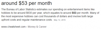

My first thought is that's a lot of math. Find a less expensive hobby :)
Looks to be an old study - but this hobby costs $$
