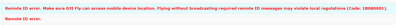

I have gotten this message a few times. last time after a 5+ minute flight. landed and then went to fly again and was blocked from take off due to RID fail. This message was in the logs. Not sure where to go with this one. Very aggravating. Any ideas. MAvi3 3 with DJI RC controller.
There are definitely some RID bugs in my experience. I get that message whenever I turn the drone on first, rather than turning the controller on first and then the drone. Any chance you are turning the controller off between flights?
I have almost the same setup, as of today I have not had any RID issues nor warnings since that rule went into effect.
( fingers crossed )
No, last time, I changed out the battery in the drone. But then could not lift. Seems alwayus to be ok for the first flight.
