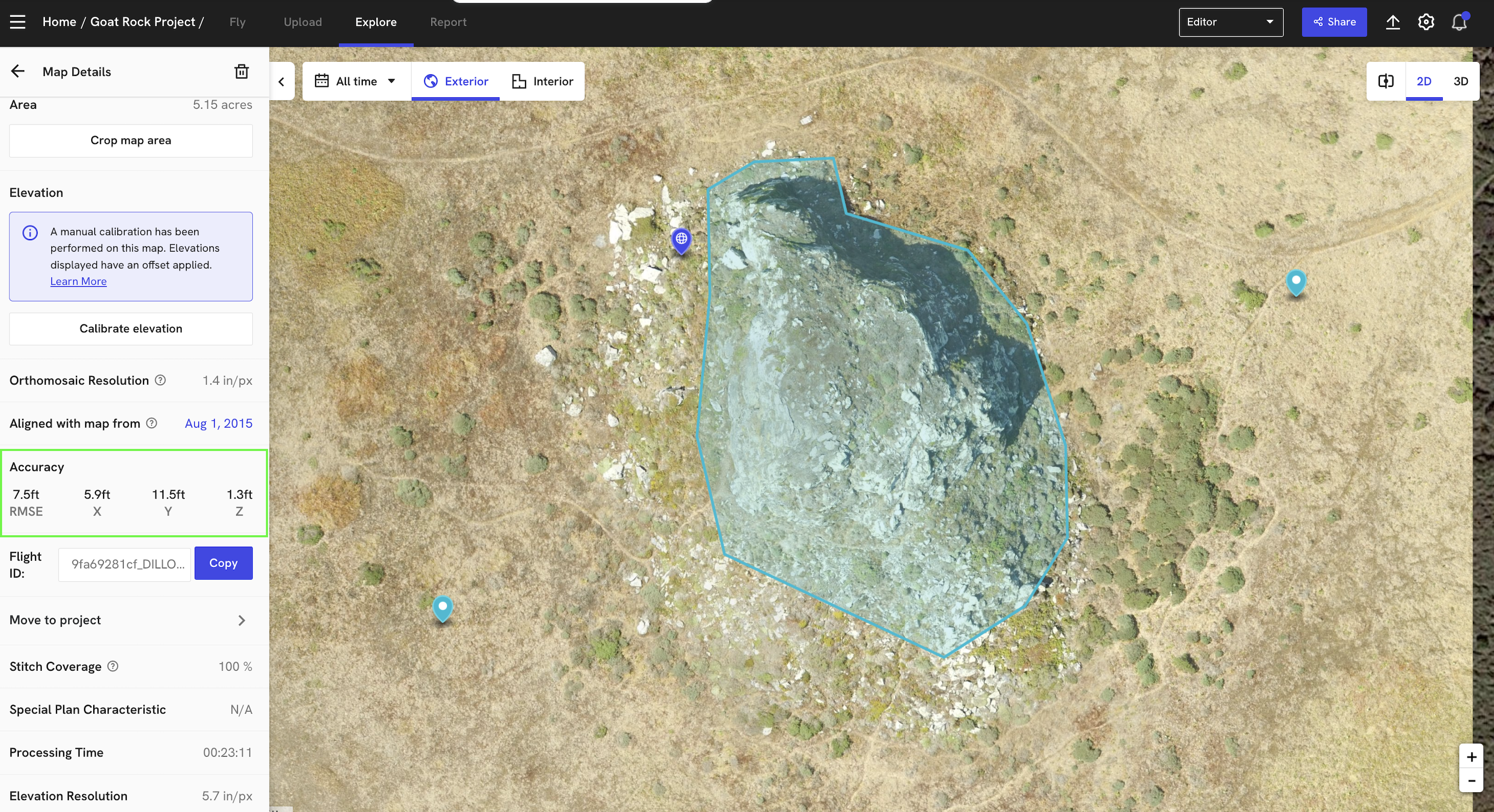

On Drone Deploy the "Accuracy" you are referring to is not the true accuracy of your map. Long story but here is an short explanation from Drone Deploy itself:
The map information panel brings up details about the map. Here, if you scroll down, you'll see the total area, the native resolution, and the accuracy of the map:
Note: This isn't the ACTUAL Absolute Accuracy, but a proxy to this.
Above, we show you where to view the accuracy on DroneDeploy. This isn't the actual accuracy, but a proxy to the Absolute Accuracy of your data. Without Checkpoints, it's impossible to know the precise Absolute Accuracy, but we work out an expectation on the accuracy by comparing the difference of where the drone thought it was (using its GPS), and where it needed to be in order to make the images overlap and stitch appropriately.
As stated above, without Checkpoints one cannot verify the accuracy of their map. This is true whether GCPs were used or not. When we process without GCP's for example, the RMSE number is the 'Optimized Camera Location XYZ RMSE' "
