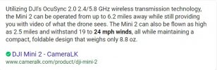

Hello,
I am new to this forum, and I am also new to drones. I am not sure if I have posted this in the right place so please put it in the right section if I missed it.
Anyway, a few days ago, I got myself Mavic Mini 2. What concerns me is its range. So, I live in Croatia (Europe), in a very small town (something like 50 000 people in total). There are almost no skyscrapers or tall buildings here. Mostly family houses. Anyway, in that urban area I have managed to get my Mini 2 something like 300m from my position and it lost signal, RTH was enabled and Mini 2 got back home. I tried in a rural area with no houses present. I managed to get something like 500m from my position and I started to get low signal messages. My flight height in both situations was something like 50m. I am not sure if this is normal, but for me, those numbers seem a bit low. I saw YouTube videos where people are flying in urban areas (and much more populated areas than my town) to something like 2.5 km. Since I am new to all this, those distances that I am achieving, aren't they a bit too low? If they are, what could be a cause for this?
Thanks for the help!

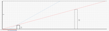

Also note that it's beneficial for the maximum distance that you try to have some distance to the nearest object that will/can obstruct the line of sight ... made below sketch with your first flight height 50m, and a 7m tall house. Where the red line starts you're standing 20m from the house ... the blue only 10m from it ... take note of what happens with the max LOS distance.
The taller building in the sketch is 36m tall & it's on 100m distance from you ... & the red LOS still clears it.
So when trying to fly far surrounded by taller objects the distance from the objects can have major influence on the max LOS distance. Try to find a park or a soccer field & start there, then you will automatically have put some distance between you & the nearest object that can block the LOS.
(Click on it to make it larger)

Also, that picture makes perfect sense. I actually managed to position myself that way so I didn't have much interference. I Have to try this a bit more but I think that I will be able to fly all over our town since all buildings are low here. The main problem was that I was a bit afraid to fly that high before and 50m is low, now I realize that :D
