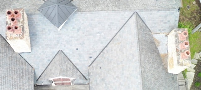

Thanks again for that.... I'm still trying to figure out how to use that program... actually how it works and how to get it... they claim a free trial but I can't get it to run on my computer or download to my controller ... Here is what I'm actually trying to do to start.. figure out the dimensions of these two chimneys within an inch or two:
