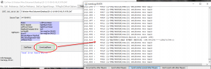

[L-FMU/MOTOR]esc[1] selftest err 0x20

Hi, Could you help me with my LOG ? I have replace ESC bored but i receive the same error this is my LOG. I think probalbly is motor ?
Can't say so much about the reason, I'm not a technician ... but in your case it says [L-FMU/MOTOR]esc[0] selftest err 0x20 ... a 0 after esc instead of 1, that indicates some kind of malfunction on the front right... motor or ESC.
Thankyou very much. Can i ask you how is method for show this error in my log, i have tryed many method but i wasn't able to see this error
Open the DAT log with CsvView ... in there click the "EventLogPlayer" -button & a new window is opened & there you can see it.
