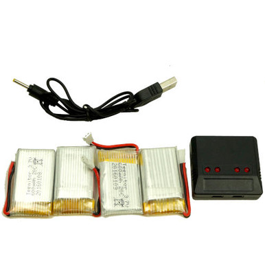

the batteries required for these units are tiny - a 60mAh 3.7v rechargeable LiPo battery with a size of about 4 x 12 x 15mm can power a DroneTag BS module for about 4.5 hours, I'd think the Spektrum would have similar results. And as for the mount, 3M velcro stick on pads are all you will need.
