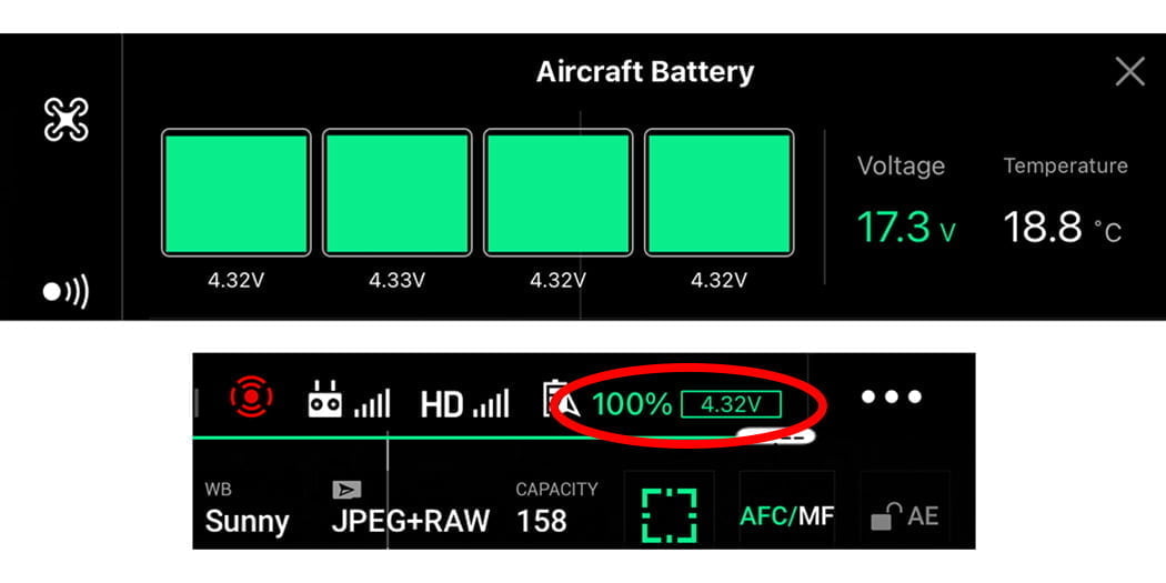

Hello guys. Somebody please clear up this confusion in my head. I have read up about battery storage and understand in general circumstances batteries are best stored at about 65% if I am correct. I understand if they are low on charge they should be charged up to this level for storage.
But what I don't understand is why they cant be stored at 100% when they are set up to auto discharge to the correct storage after 1 day! I can understand why storing them at 100% continuously is a bad idea but surely if they are put away at 100% and they discharge to the correct storage after 1 day where lies the problem?!
Is the heat given off whilst discharging over 1 day a serious danger?
Thanks for any help!
They can be stored at 100% -- and that's likely what most people are doing. There's no need to manually discharge the batteries down to the storage level. That's why the auto discharge feature exists and it'll handle that work for you.
While the auto discharge process might start after 1 day, it could take a few days to discharge the batteries down to the storage level. But, that's fine. As I mentioned above, it's okay to store your batteries at 100%. And it's more important to charge them up to the storage level (if below that) when putting them into storage.
No.
