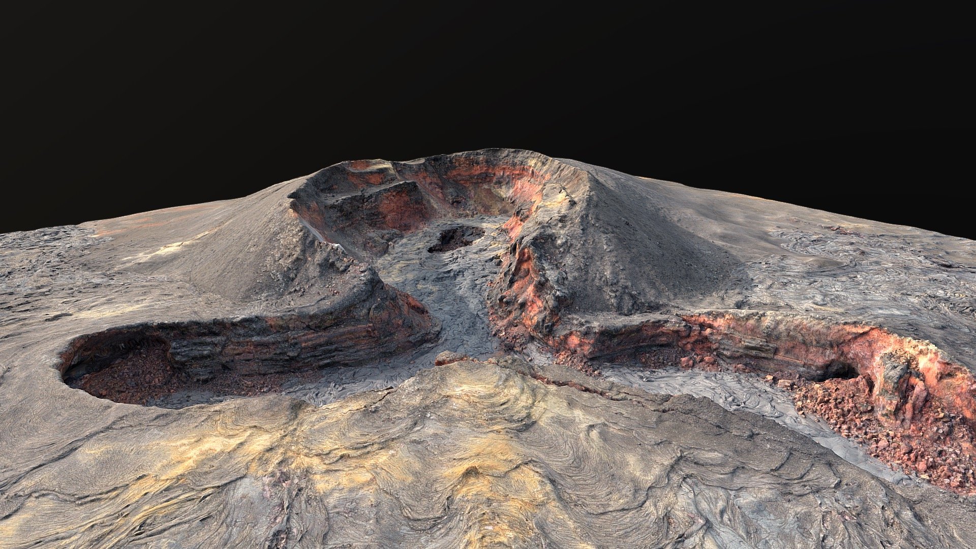

Exact same workflow, even down to the P4p... or Obsidians in our case.
This is one we are particularly proud of... especially as it is less than 1/4 from our Office/Home.
2018 - 60,000 GPS (that's a second) of molten lava spewed outa this one fissure alone.
