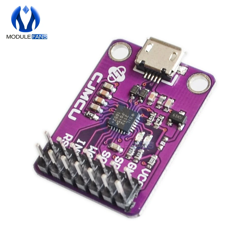

There is a main requirement - not to overheat li-po elements. 100w makes soldering very quickly due to its power, the heat does not have time to reach dangerous chemistry. I use an acidic flux, then wash it very thoroughly with alcohol. The controller that you have left must be unlocked after soldering the new 3500 elements. It is very easy. And it only costs $3. The program is free, and CP2112 is on Aliexpress. Make a battery, order CP2112 and I will teach you how to unlock.

I made a short video on unlocking the Mavic Air battery controller. Look, it's fantastically simple. The developer of the program, my friend Mikhail, (we live in Ukraine). He gave his program absolutely free. The video is in Russian, but it is possible to understand the general meaning.
Thank you so much! I will order CP2112. This is really interesting stuff! Slawaw I'll get back as soon as I receive it. I very much appreciate this information.
