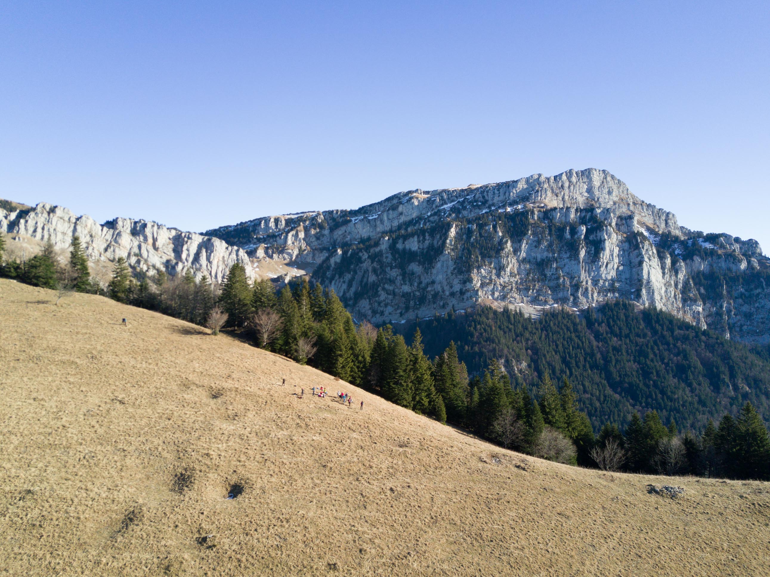

I'm having the same focus issue with the Mavic Pro, and as some people argues, at first I believed it was a Mavic Pro limitation or myself using it the wrong way with the "tap to focus".
So I checked my stills and videos to understand, and did some lab tests. I found that the focus of the Mavic is not regular on mine. I mean, if I'm focusing on the middle of a wall, the Mavic being perfectly facing on, the middle of the wall is in focus, the right part of the wall is in focus, but the left part isn't.
In other words, the depth of field is not the same depending on the part of the image! As I discovered this, I understood that no update would correct this. I'm currently returning my Mavic to get the camera replaced, or the whole thing if faster.
This is an example of what I'm talking about. You can see that the right side of the image is perfectly in focus, while the left side isn't. The problem is that both sides are at the same distance. QED.
