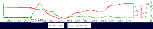

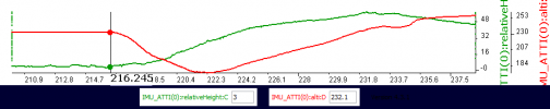

The problem appears to be a HW fault in the Z axis accelerometer. There are several data that indicates the Mini was ascending, including the pilot's description. However, IMU:alti (red) is showing the Mini is descending.
IMU:alti is the result of the Flight Controller's fusing algorithms and is dependent on IMU:velD. Comparing IMU:velD against GPS:velD it can be seen that IMU:velD is incorrect.

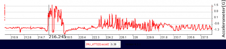

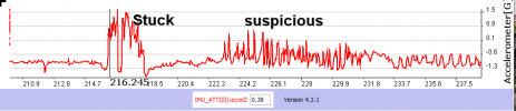

Finally, IMU:velD is dependent on IMU:accelZ
If the Mini is accelerating upwards then accelZ should be negative. Also, the accelZ data starting about 222.3 secs looks a bit suspect.
Looks to me like the Z axis accelerometer gets stuck positive causing the FC to think the Mini is loosing altitude. To compensate the FC commands higher thrust causing the Mini to ascend.
The questions remains what causes the accelZ to get stuck. I could speculate but what would be the point? It's clear, at least to me, that the problem is a HW fault.
