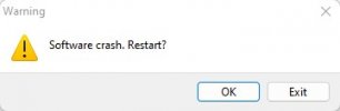

Hi
whenever I want to open a directory with images, the program crashes.
I use Windows 11.
Does the program work for anyone?

Contact the developer of the software or support from where you bought the software.
I got an answer from DJI Support:
Thank you for your patience. There is indeed a current issue with the current version of Thermal Analysis Tool 3.0. Until the problem is solved by an upcoming update, you can try to set the compatibility mode to Windows 8 in the shortcut properties.

Well, we're well into 2024. I just installed Thermal analysis Tool 3.2.1 and it crashes as soon as I open it. It didn't work not even once.
