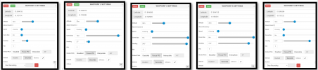

Hey - here you go. From today. I'd create a new mission as below. As you can see the blue arrows do point towards the POI
Here's the mission settings:
And here are the 5 waypoints:
