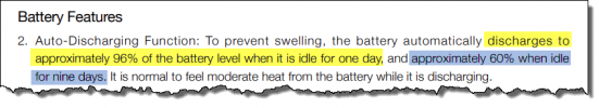

... do the M3P batteries still perform something similar as they are also designated ‘intelligent’?
From the user manual ...
And most probably the counter resets if the battery button is pressed to check the charge status ... so in practice & by mistake a battery can be on a very high charge state longer than those 9 days.
