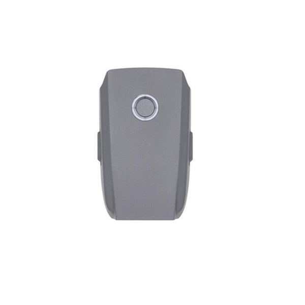

Hello I’ve had my Mavic two pro since release all three batteries are swelling up this year I live in Texas it’s been very humid but I haven’t flown but maybe twice a week I’ve done nothing different except not fly as much as I used to I had a wonderful dog that love to go out and fly when I told him are you ready to fly he would spin around bark and wag his tail he knew what we were going to do I’m broken over this but that’s not why am making this post does anyone have any suggestions and have you had any problems with your battery swelling up I’m in disbelief everything was perfect until this year not only that my phantom for pro is doing the same thing all three batteries are swelling up it seems funny how all six batteries have had a swelling problem this year and now I need to know from you guys should I even trust these batteries to fly I do not want to lose my drone my work is slow I’m electrician and I don’t have the funds to buy new Drones so I’m saving up I’m going to get new batteries do they only last so long or is it the humidity that is made all of my batteries start swelling, we all know how Dji is they’re not going to work with me on replacing them and they’re so expensive I’m looking at over $1000 to replace all my batteries but it’s worth it if a crash is coming which I’ve never had happen any suggestions I would be very appreciative, Plus I wanted to share my pics from Fourth of July I was in shock how good they came out because I did no editing and when I got there I just shot it straight up and started taking pictures and when I put them on my computer when I got home I was very happy on the results so I wanted to share these as well but I need to know about my batteries

Humidity have nothing to do with that your batteries swell ...
Gas generation in lithium batteries is a normal thing. Even if you don’t abuse your battery, the normal everyday use of your battery will generate gas through a process called electrolyte decomposition.
The electrolyte decomposition occurs even faster if you overdischarge a battery, overheat a battery or store them outside storage voltage (3,7-3,8V).
Electrolyte decomposition is what happens when that electrolyte chemically breaks down. So in a lipo battery, as the electrolyte breaks down you end up with lithium and oxygen. This forms lithium oxide on the anode and cathode (depending whether you are charging or discharging), this increase the internal resistance which make the battery more prone to larger voltage drops during higher amp load.
But what you also end up with is excess oxygen that doesn’t adhere to the anode or cathode. This excess oxygen is part of what causes a battery swell.
Oxygen likes to burn... doesn’t mean that every battery that is puffed is going to explode as soon as you use it but it does mean that a high enough percentage of them are going to be dangerous that it isn’t worth the risk to continue using them.
My advice is that you stop using them immediately & dispose of them completely discharged in a proper way ... this as it isn't a fix for swelling & that they can be dangerous.

So easy to pick up, and fairly common knowledge the M2 batteries do this time to time, there was a bad batch, plus not sure the flat backs allow any expansion when they get warm when flying them.
OP @maven4336 . . . some members here have had the M2 bad batch batteries replaced free by DJI, and LONG after warranty expired . . .

Yes, this was my experience. Three batteries bought in early 2019 replaced free this spring after I documented the swelling. Others have reported the same thing. Contact DJI support.

Drone manufactures push their batteries super hard (Densely packed cells, high current draws, high temperatures), and their lives are limited as a result (The Mavic 2 are rated at 200 cycles by DJI). There are also things you can do to help, for example limiting use of high performance modes, letting the batteries cool down properly before recharging, and not keeping them charged when they don't need to be.
Also worth noting that very little room was left for the cells to swell in the Mavic 2 design, which means running with swelling cells gives you a high chance of the battery "Popping" out in flight. I would cease use of the swollen cells immediately.
