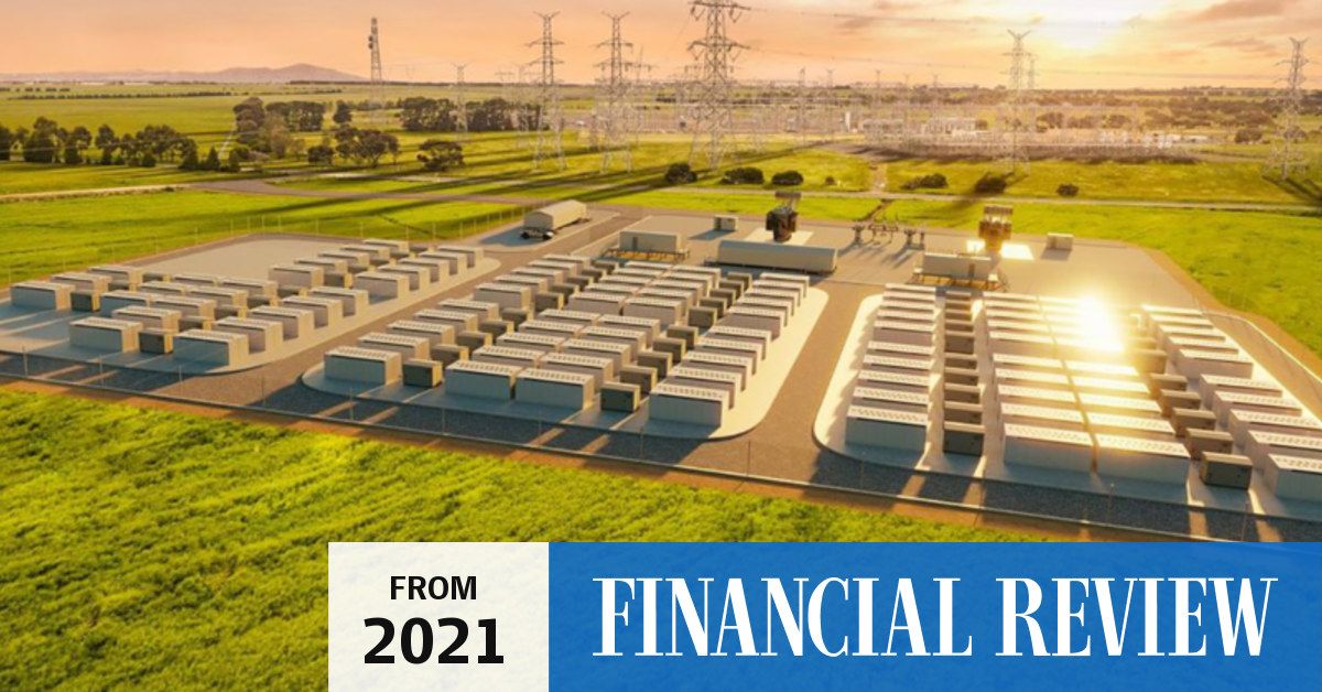

Because wind turbines are an "interest" of mine (I'm an opponent) and the current trend is to use lithium batteries for storage, the risk of a thermal runaway and fire is significant. AS an example. the battery fire at the Tesla Mega Battery in Victoria, Australia this past July showcased the hazards of such. Tesla's recommendation to fire fighters was to let it burn out and try to keep the surrounding batteries cool. It burned for 76 hours releasing toxic smoke (hydrogen fluoride) to the surrounding area. Nasty stuff and extremely hazardous. Obviously this fiasco is on a much larger scale than our batteries.
How similar are the lithium ion and the lipo batteries pertaining to potential risks? Are lipo bags effective ?
EDIT**** Correction - Moorabool, South Australia - Victorian Big Battery - Tesla Megapack battery units
There is no Tesla mega battery in Victoria.
Perhaps you meant South Australia.
There are a lot of wind farms in the region where I live.
They all connect directly to the national grid, none have battery storage.
Reactions: diesel97
There is actually, near Geelong (edit, north of Geelong, Moorabool)
There was a lithium battery fire during commissioning . . .
