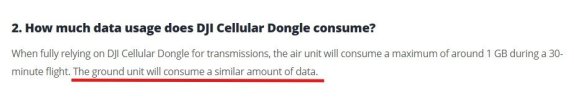

I saw this on the DJI website.
What does this mean?
"The ground unit will consume a similar amount of data".
Does it mean you will use the same amount of data if you not using Wi-Fi?
Correct?
Yes. Note that this is a two way data communication, one side has to receive the data, where the other part is sending. Do not think as a phone call where the caller pays the cost. No.
