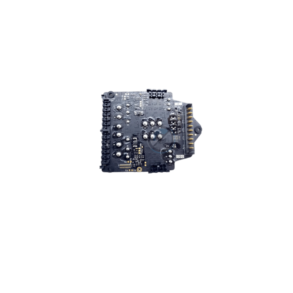

1. Reinstall the firmware.
2. It is not returning with an esc error number hmmm. Try post #11
3. You can purchase the board and install it.
Sorry YES, If its under warranty 100% agree Send it back to DJI.

Has your mav.2 pro been flown either by you, or your friend since being bought?
When you say bought new: was it: 1) through an official source (DJI store or affiliate)? 2) an outlet specialising in 'previously loved' electronics or 3) from a private buyer?
If the first or second: you may have recourse for a repair or replacement through them. If the third: a reputable drone repair business can replace the ESC board. As already suggested, this isn't too difficult to sort out yourself as long as you're careful, methodical and patient.
