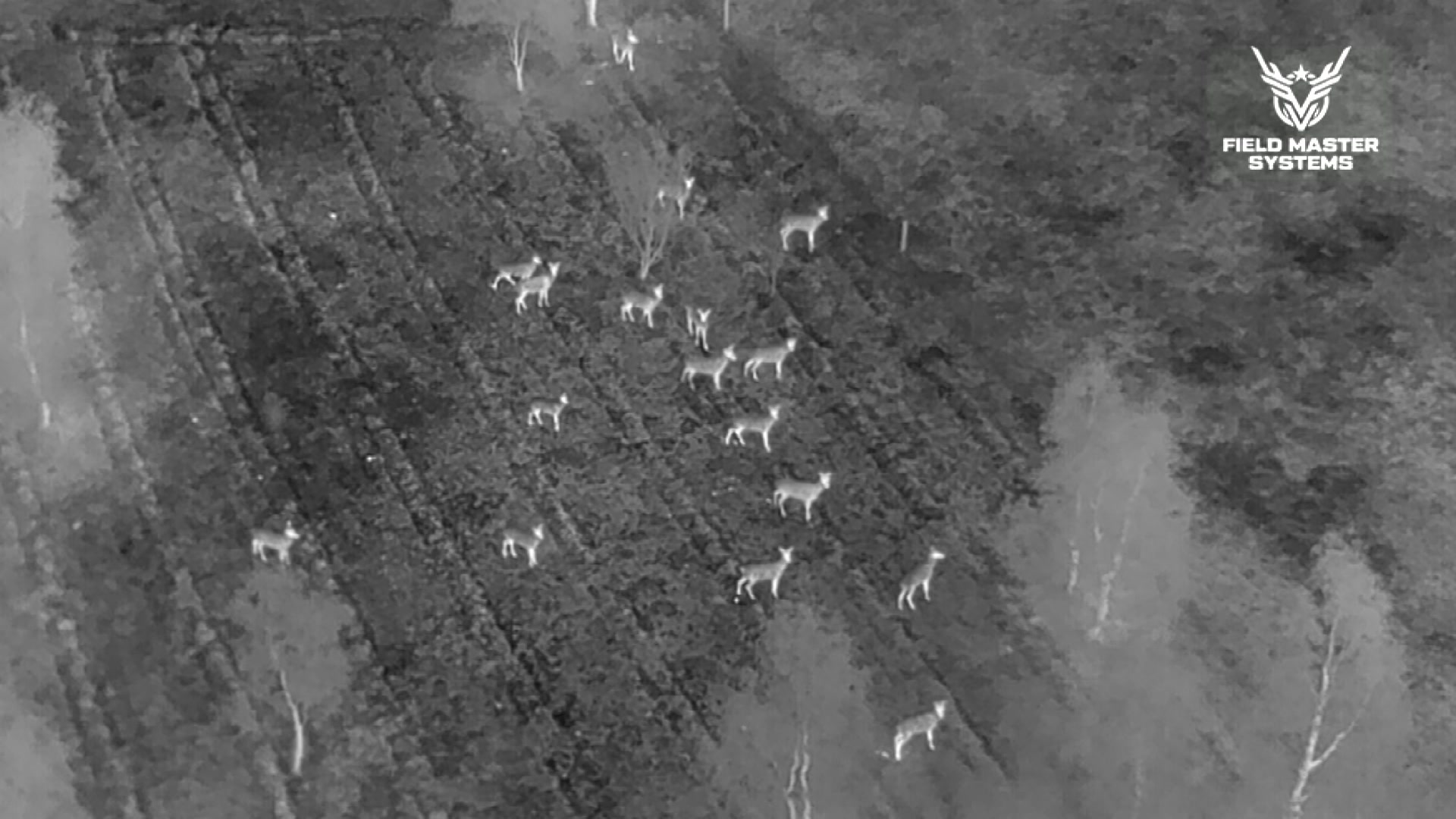

Heaps.
But here are some good reasons for spending the money.
Would like to see this video?
