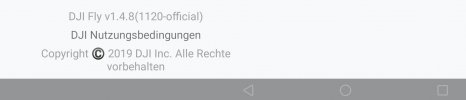

Hello,
there were 2 versions of the Fly App 1.4.8, the current one = 1120. The previous version 1116 was secretly exchanged for the 1120. Check your version and download the new 1120, this may fix the error.

I have just downloaded the new 1120 version of 1.4.8.
Why would they have two different versions with the same version 1.4.8? Or why do this secretly?
Follow up to my last post. I took the advice of Bruchpilot and uninstalled the 1.4.8 app that was causing problems, and I downloaded and installed the v 1.4.8 with the extension 1120.
I flew two flights this afternoon and it seems to work ok.

That's good to know; thanks for the update. I updated to v1.4.8 almost immediately after it was released, so it was probably variant 1116. I updated it again to variant 1120 today, and will try it out later this evening.

greetingView attachment 132182
Thank you for letting us know about this... wonder why DJI doesn't announce this and what has changed?

I have flown at least half a dozen missions since deleting the first version of 1.4.8 and installing the 1120 version and I am happy to report that all seems back to normal. No more unexplained crashes of the app.
