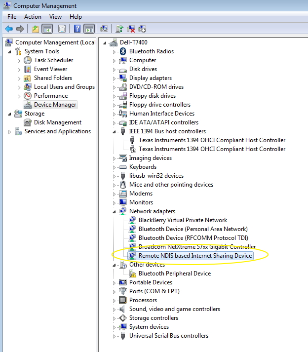

Just a thought, poorquad, something to check. I was stuck trying to get DUMLdore and Assistant 2 working properly for weeks and with the help of others finally found my problem.
Assuming you're using Windows, use right-click on My Computer, then select Manage and then Device Manager, with your Mavic powered up and connected via USB to your computer.
Under Other Devices or as in my case, "Network adapters", which is why it took so long to find, look for a driver entry called "Remote NDIS based Internet Sharing Device" - you won't see this if the Mavic's not connected. Right-click on that driver, then Properties to see if it's disabled. If so, enable it. That was my problem all along; the RNDIS driver was disabled. Once I enabled it, and since, DUMLdore has been working perfectly along with Assistant 2 in both regular and debug modes.
Here's a screenshot illustrating the driver location:
Good luck resolving your problem!
Thanx for the tip, I went to DM and checked it out, it was enabled and functioning properly, I have reassigned com port and everything, I'm about to hang up the towel and stay with the crippled .1000 fw I guess.
