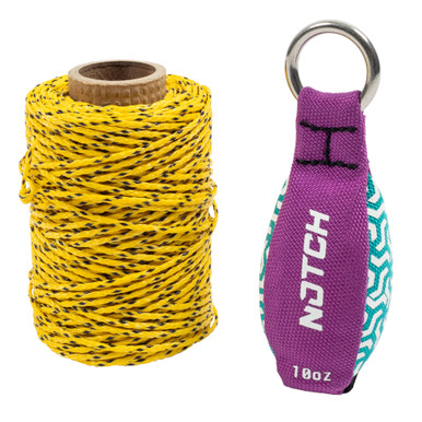

Alternatively, you could try an arborist throw line and weight in hopes of snagging the drone and bringing it down. Takes some technique so you’d need to practice a bit. Here’s a link to a basic kit:
