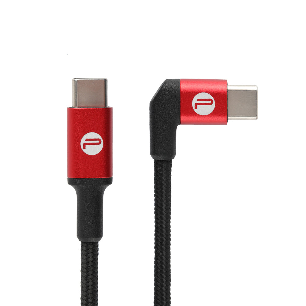

Glad it may help some… although that’s not even a USB3 cable… just listed as a USB-C… which unless specified USB3 or USB3.1 it’s a standard USB with USB C terminals... although it is assumed 2-way data terminals by it’s description.
Personally, I feel it’s more Fly App issue conflicting with some 2018 iPad Pro 11’s than cable.

Disappointing news. I ordered this exact one from your link and got it yesterday. It does not work with my iPad Pro. I am not sure why we are all having different experiences with these usbc cables but it is pretty **** disappointing as I have tried 4 different brands now and have switched the cables back and forth between controller and iPad. 0% success

Take the connector out of the USB-C out of the remote, turn it round and plug it back in, USB-C connectors are reversible so can be inserted either way round, one way works & one way doesn’t in my experience when trying to get USB-C working with an iPad Pro.
