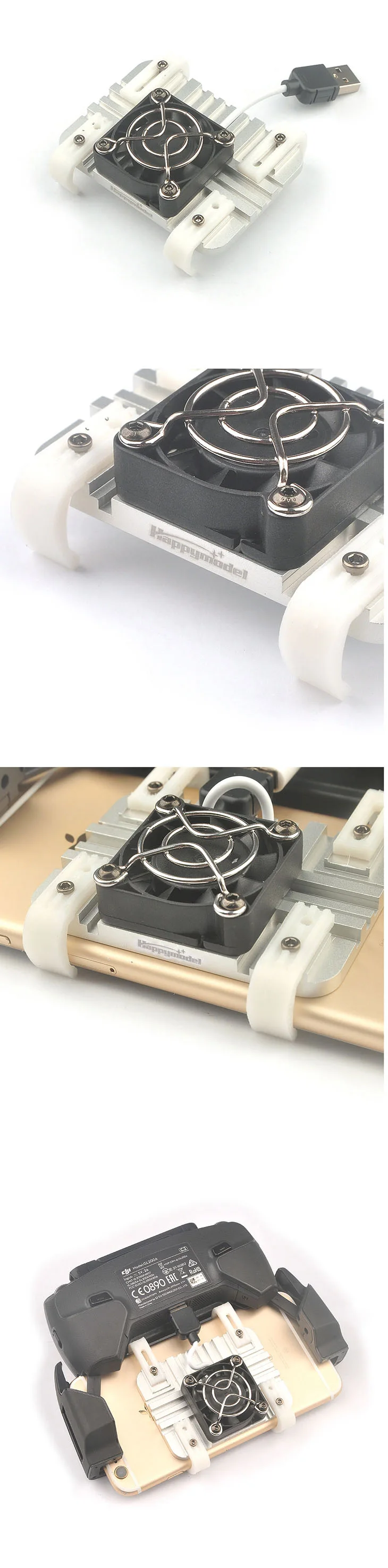

I had the exact same issue with iPhone 8 Plus, 5 minutes on max brightness and iOS will start dimming the screen by half, another 5 minutes, down to about quarter of the max brightness making it very difficult to see even under the shade.
I found that DJI GO4 is very CPU intensive, it heats up the iPhone much faster than when flying with Litchi app.
I'm going to try this cooling fan attached to the back of iPhone, see if it helps. Still waiting for the arrival of the item.
Smartphone Heat Dissipation System Cellphone Cooling Fan for DJI MAVIC SPARK Suitable for Iphone Android Smartphone-in Drone Accessories Kits from Consumer Electronics on Aliexpress.com | Alibaba Group
Interesting. Let us know if it works please. It's pretty cheap
Sure, will report back once tested.
I do hope it works, otherwise will have to DIY one with larger fan with external power source.

I’ve tested the cooling fan. It works great, no dimming with max brightness in 27C ambient temperature with my DIY sunshade.
I attached the fan onto my iPhone 8+ with a thin skin case. I guess the heat dissipation would be even better if the heat sink is in direct contact with the iPhone without a case but that would risk scratching by the heat sink.
The 3D printed clip is a bit rough, either have to sand it smooth a little or print your own finer clip.
