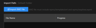

I am not familiar with Pilot 2 and its requirements. All of my testing has been done in DJI Flight Hub 2:
And the import function:

If you wish to uncompress a DJI KMZ file, simply use either "unzip", or change the extension to ".zip" and use the built-in Windows uncompress command. A DJI KMZ file will contain two files: template.kml and waylines.wpml.
