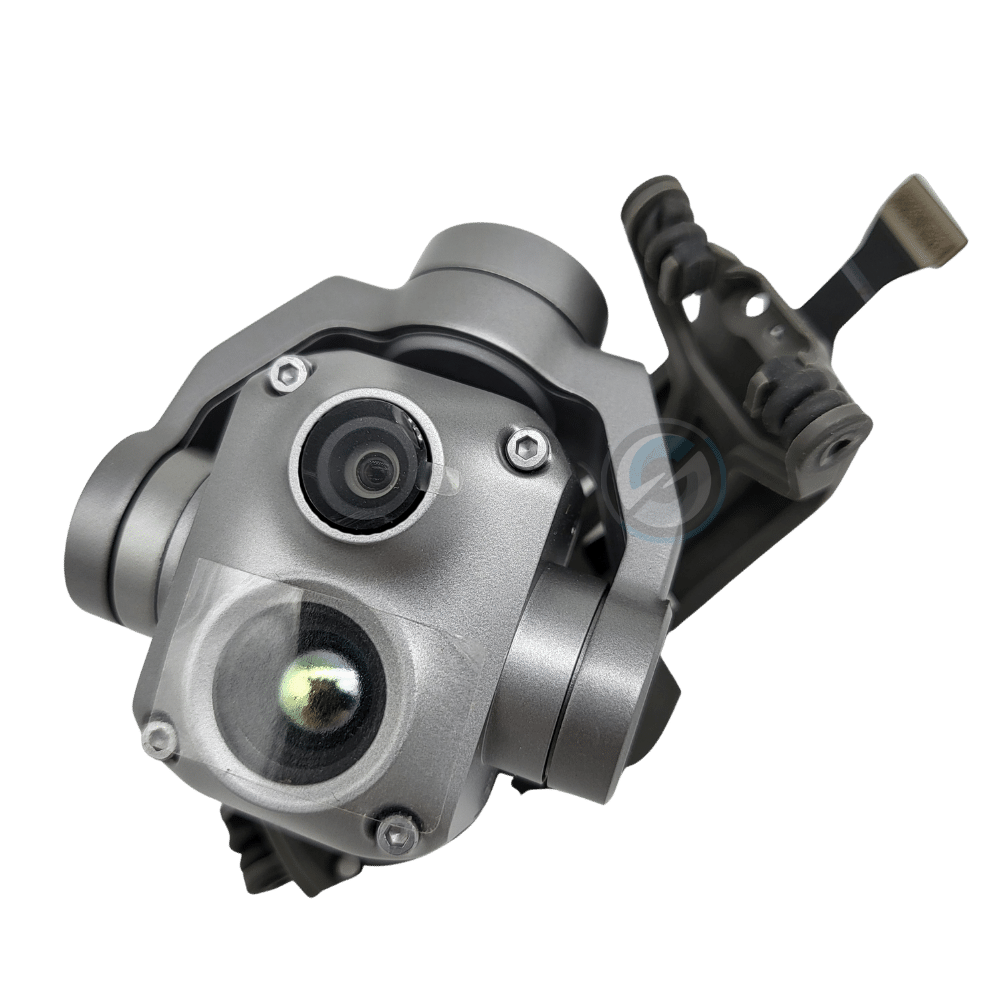

A few simple tests indicate that it is FFC failure, presumably due to the shutter not closing to perform the FFC. If I disable auto FFC and perform a manual FFC with a uniform temperature object filling the field of view, then the camera works fine. Performing an FFC with an actual view fails because the shutter doesn't close, leading to the actual image being subtracted in the calibration - hence hot objects then ghosting as cold when the camera view moves.
The camera module does click on FFC, but presumably that's the solenoid attempting to function but failing to close the shutter.
So the system is usable with a manual FFC before flight and auto FFC disabled. Not optimal though, obviously.

Cloud City drones is my go to for OEM DJI gimbals as I know I am getting brand new original parts.
They do have the full assembly if you want to self repair.

Unfortunately Care has expired on mine. I'll open a ticket and see what they suggest.
Since the main purpose of this aircraft is SAR, I could probably also live with manual FFC. I did a few more tests and it turns out that the shutter is partially closing on FFC. It appears to come in on a diagonal, and the lower left ⅓ or so calibrates properly, while the rest calibrates on the camera view and causes the ghosting.
