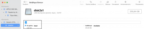

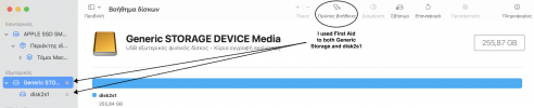

The SD card is not faulty, says Mac's Disk Utility. I used first aid to both Generic Storage and disk2s1, as seen below.
The SD card available space is huge. It should not be, I used more than a half of the whole memory to film with my Mavic.

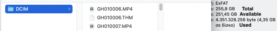

Most of the files in the SD card do not seem to have any size (the number is close to zero, only a few KB).
