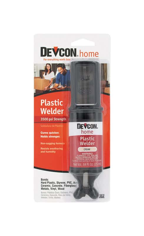

I would try this on plastic:
Devon  High Strength  Plastic Welder  0.84 oz.
Roll Over to Zoom
Devon High Strength Plastic Welder​
