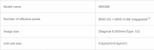

Sony's website indicates that the IMX586 sensor that the Air 2 uses is 8000 x 6000 effective pixels. The pixels are 0.8um x 0.8um which yields a sensor size of 6.4mm x 4.8mm

@Saladshooter - Perfect! Thank you very much for this information - very much appreciated!
