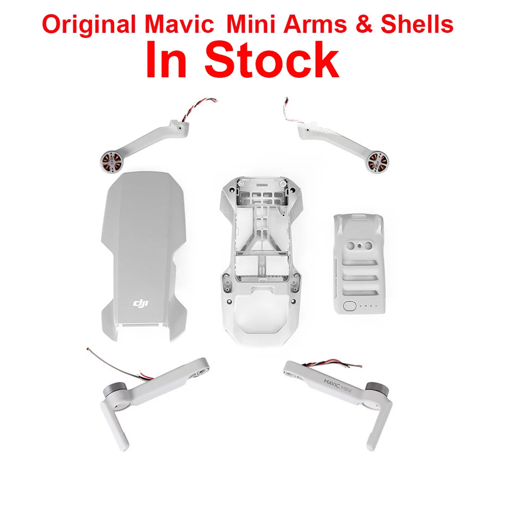

it is all already available on aliexpress.
front arm assembly is $18 - but i am afraid to pop up the upper plastic shell of MM may be a bit of a problem. but, a replacement is just $10, so, all in all it is the least expensive drone so far, if central motheboard will prove itself resilient to crashes, it is as simple to repair as it can possibly be.
PS. they run 20% discount now on this set, and the whole thing shown above is $115 shipped, with a paypal fee.
Wow.....wow wow.....thanks for the heads up......
