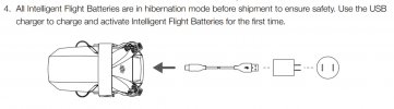

Did you try charging the batteries in the drone itself rather than the charging hub? If not, give that a go...
The battery is probably in hibernation mode, similar to when they are shipped.
