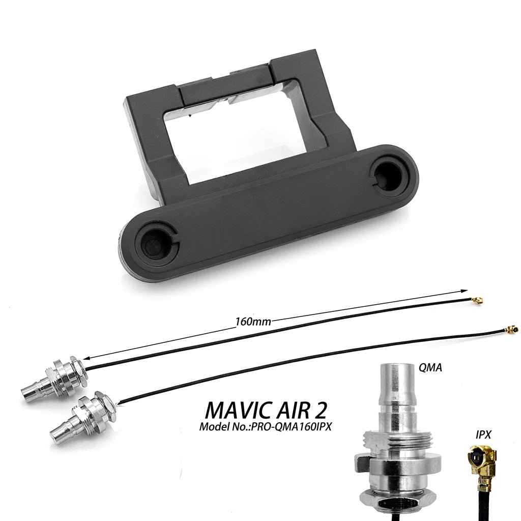

Alientech quick connect kit
The quick release qma to sma connectors are about 10 bucks each. I would use the bracket from the kit and use the regular sma or rpsma connectors.

Here is a pick of my prototype. I am building a nice case to hide all the components. I also use a plain old 3s 1000mah battery to power them and that is more than enough and good for about 12 flights. Ugly but works awesome.PXL_20220421_234727312.jpg
