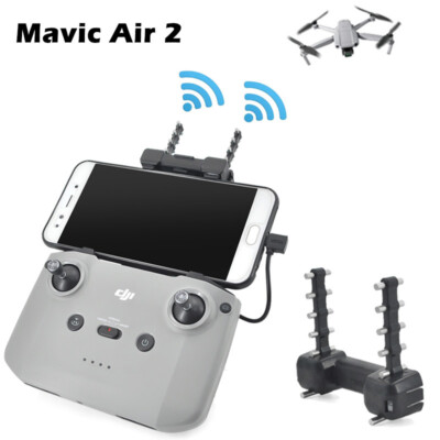

Might think about a Yagi-UDA signal extender. I use a 2.4GHz model. Extended my reach by 200%.
I chose 2.4GHz model as it is more forgiving in its passage around obstacles. Some say the 5GHz is stronger longer, I dont believe thats correct. For certain it (5GHz) is obstructed quickly by forested areas. Both suffer when encountering whetted forest canopies.

Is that one of these?
Seems alright if it works well as you say but bearing in mind I have the CE it might be a tad less effective

I have both the 5.8ghz & 2.4ghz Yagi range extenders for my MA2. I use the 5.8 in more built up areas, & the 2.4 for extended range in less built up areas.

The 2.4GHz is more prevalent in a city environment thus the 5.8GHz option encounters less interference. This doesnt mean it (5Ghz) penetrates obstructions at any greater extent. It doesnt. A crowd makes a lot of noise. A less crowded 5.8GHz band doesnt mean greater distance. The 5.8GHZ band is very narrow and peters out more quickly.
As remarked upon, "2.4 for extended range in less built up areas." is a correct course of action. When flying above it all and at a suitable LOS angle of the dangle a 5.8GHz connection, in the city, would be advisable.
Id also raise your angle of the dangle. Higher altitude to avoid whetted forested areas which are dreadful to signal penetration.
