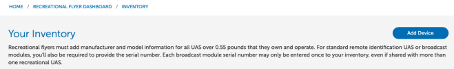

Actually it does appear to require the aircraft serial number. This is the recreational dashboard:
And this is the resulting "Add Device" window that appears - serial number is shown as a required field:

That meaning of "SERIAL NUMBER NOT APPLICABLE" isn't explained anywhere though, and most people seem to assume it refers to homebuilt aircraft that don't have a serial number. And that field doesn't go away when you choose "NO" for "DOES YOUR DRONE BROADCAST FAA REMOTE ID INFORMATION?*"
The only potential inference of that interpretation that I can see is from the statement "Recreational flyers must add manufacturer and model information for all UAS over 0.55 pounds that they own and operate.", which mentions model information, but not serial number explicitly.
Do you have a definitive reference that it is not currently required for any aircraft?
Do you have a definitive reference that it is not currently required for any aircraft.

Heard back from the FAA. They're response with some redactions.
"Hey Vic,
This feature was added to DroneZone back in April following publication of the Remote ID rule. I think of it as a placeholder until September 2023. Recreational Flyers just need to add at least one device, and then they can register / renew. The answer to the “DOES YOUR DRONE BROADCAST FAA REMOTE ID INFORMATION?” question remains “NO” for everyone. When the registrant selects “NO”, the ‘Add Device’ window will ask for the [aircraft] serial number. When the registrant mistakenly selects “YES”, it will ask for the [nonexistent] Remote ID Serial Number. We have been contacted by a number of stakeholders who wish to renew their existing Recreational Flyer sUAS registration, and then they get stumped by DroneZone telling them that they don’t have any registered inventory. Well, prior to April of this year, we only asked for the first and last name, email address, and physical address of the registrant, so they don’t have any saved aircraft info.
Practically speaking, that guidance is still spot on, a Recreational Flyer registration is for an individual rather than a specific drone. A Recreational Flyer may use the same registration number on any number of drones / model aircraft as long as they are flown for exclusively recreational purposes. (See 14 C.F.R. §48.105 and 14 C.F.R. §48.110).
I like the way you worded that… “prematurely reflecting the upcoming RID requirement”. Pretty much. I also copied in xxxx in this response as well. xxxx has been doing quite a bit of work trying to improve DroneZone."
I hope this clears it up.

I don't want to labor the point, but the response above that you got from the FAA doesn't really make sense.
So the "Add device" page is partly a placeholder for future RID information, which is why when you answer "YES" to "DOES YOUR DRONE BROADCAST FAA REMOTE ID INFORMATION?", the data entry field changes to ask for the RID serial number:
Fair enough. But if you click no, then it asks for the aircraft serial number:
So what is that a placeholder for, especially if they are not going to require an aircraft serial number now or in the future? This doesn't appear to have anything to do with the RID stuff.
Also, the instructions state: "Recreational flyers must add manufacturer and model information for all UAS over 0.55 pounds that they own and operate." Without the serial number, how would that work if, for example, you have two of the same make and model?
It's not a huge deal, of course, but how on earth did they manage to make such a simple process so confusing and self-contradictory?
