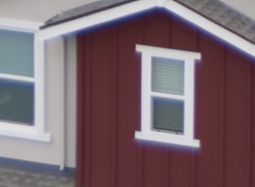

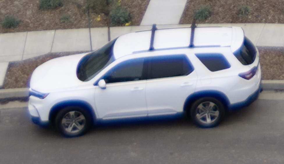

I purchased the K&F Concepts wide angle for for the Mavic 4 Pro and its... ok. There is some strange fringing (examples below along the windows of the white car and the windowsill in the second image) and a little loss of sharpness. The curvature isn't too bad... fully manageable in Adobe Raw.
If you want to download the raws and see what they look like with the K&F wide angle, have at it. I had a small window to get up and shoot a few with the adapter before the the cloud cover was too low. I am in California's Central Valley so we have been dealing with tule fog that has settled in for the last few weeks... so nearly constant cloud cover at around 250ft AGL. I was hoping to have more time to shoot at different apertures to see if it improved sharpness and fringing, but ran out of time due to weather.

I too have not had much chance to exercise it in the field. Actually been flying the aircraft a lot the last couple of weeks, at least when the WX cooperated. I am curious, did you try the Photoshop d-fringe in the Camera Raw Filter to see if it corrected it? Really never tried out that feature, this looks to be what is was designed for. The K&F while not suffering the poor quality control of the STARTRC offering, isn't nearly as good as any of the ones offered for the Mavic 3. The DJI and Freewell were both super. I suppose that the lens sits a tiny bit further from the prime lens on the camera of the Mavic 3 series. Not being any kind of optical engineer, but I did take a nauseating amount of Physics, harder to gain precise focus control when you separate lenses too much. To get color convergence it is even more difficult unless you use special glass, expensive glass. Used to be a big problem decades ago, then the higher refractive index glasses came a bit cheaper and the proliferation of glued multiple lens sets. Not going to happen in a $60 supplemental.
I did. It primarily looks for green and magenta fringing. For some reason with this adapter, the fringing appears to be blue so it didn't really do anything.

That is correct. The fringing is not present when the adapter is not used.
Just a thought.. Capture One software has excellent defringing tool where you can not only pick the color but also select range of the fringing color to be removed. Not sure if Photoshop does it?
That is true. I shot these just as quick samples and share with other people thinking about purchasing this adapter, so I haven't done a ton of work on them... just wanted to share what a saw in uncorrected images.
