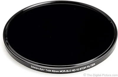

I am new to Nd filters and need one that’s good for bright conditions. Would this one be good for that?DD890BA0-1B84-4E47-898B-F775C1C90BBE.jpeg

Probably not .. it only lets 0.1% of the light through.
What do you want filters for?
If you are shooting stills, ND filters won't do anything to help you (unless you have a particular reason to want to use long shutter speeds).
If you are new to video, you'll still get good results without them.
Some advanced video shooters use them and many on forums will recommend them but they aren't as necessary as many believe.
The ND1000 is a 10 stop ND filter and cuts the light too much for general use in drone videos.
It's more for making 1 minute exposures with still cameras locked down on a tripod.

thank you so much for the info?

Obviously the ND1000 in post 1 is only for long exposure photography, very little use in video I would think.
With photos, it also shouldn't change how a photo appears in regards to light etc, except a higher ND stop will also create longer shutter to create motion in flowing water, ocean waves, or other movement like vehicle taillights at night.
