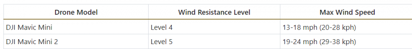

Be very careful with the Mini, it has the lowest wind resistance of all the DJI drones.
Level 4 - 8m/s, or 28km/h.
